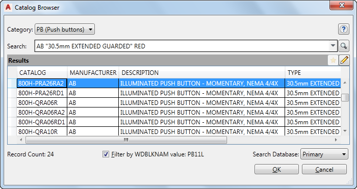

Catalog Browser Dialog Box
Insert a component from the catalog database, assign a catalog value to a component, or edit the catalog database.
Find

Category
Selects the catalog table to search.
The category is preselected when:
  • Using the browser in lookup mode to assign the catalog value to a component. The category is based on the selected component.
  • The project is set to Always use MISC_CAT table.
Search
Specifies the search criteria. A search is performed only on the fields that are displayed in the browser. The AND operation is assumed. Using OR and "exact phrase" expressions are supported.
Examples:
  • Red Illuminated - displays records that contain both Red and Illuminated in any of the displayed fields but not necessarily together
  • Red OR Illuminated - displays records with Red or Illuminated in any of the displayed fields
  • "Red Illuminated" - displays records with the exact phrase in any of the displayed fields
As the search text is typed, manufacturer names and previous searches that match the search text display in a drop-down list.
Note: Sub-assembly items, as defined by an ASSEMBLYLIST value, are not included in the search results. Use the edit mode of Catalog Browser to view and edit sub-assembly items.
Performs the search based on the search text.
Displays the catalog entries previously added to the favorites list for the active category.

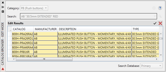

Switches to the edit mode where you can add catalog entries and edit existing ones.
Search Database
Controls which database is active; primary or secondary. If there is no secondary database defined for the active project, the secondary option is disabled.

Edit Mode Only
Commits the edits to the catalog database.
Cancels the edits so they are not written to the catalog database.
Edit Mode Context Menu
Right-click on a catalog record in the results pane to open the context menu.
Cut, Copy, Paste
Cuts or copies the selected cells. Pastes previously cut or copied content.
Copy Row
Copies the rows for all selected cells.
Paste Row
Pastes a previously copied row at the end.
Delete Row
Deletes the rows for all selected cells.
Weblink
Displays the URL or document associated with the record as defined in the Weblink field.
Assembly Details
Opens the Bill of Material Check dialog box where you can view the details for the main catalog and any associated subassembly items.

If catalog lookup is selected from one of the Insert/Edit dialog boxes, the Catalog Browser opens in the lookup mode.
Filter by WDBLKNAM value
When checked:
  • Records that contain a WDBLKNAM value that matches the symbol block name are included in the results list.
    Note: If the first character of the symbol name is "H" or "V", it is ignored in the WDBLKNAM match. For example, the symbol name HLT1G.DWG matches the "LT1G" WDBLKNAM field value.
  • Records that contain a blank WDBLKNAM value are included in the results list.
