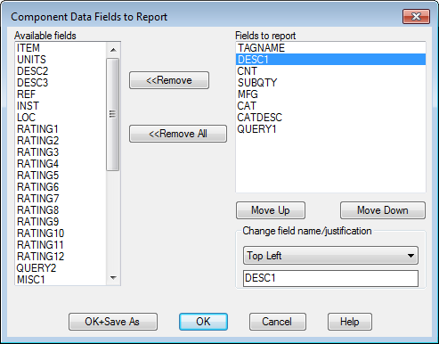

. Find
Report Name: Component
Active Drawing
Click OK.
In the Report Generator dialog box, notice that 9PB-12PB are still listed in the TAGNAME column of the report.
Desc1 moves into the Fields to report list. These are the fields to display in the Component report.
The Report Generator dialog box now lists the TAGNAME and DESC1 values from the active drawing.
