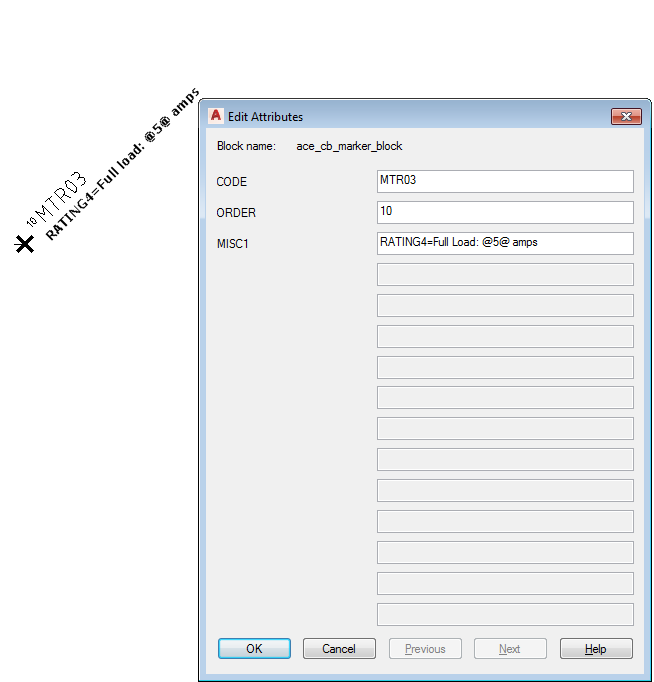

The elements in the first sublist of the "#data" list are held in memory in the following order. The values related to the motor are held in the first eight elements. See the API documentation for a complete list of elements.
There are two ways to map these values to the attributes on a component.

Before:(c:ace_cb_insym #xyz nil "HMO13" #scl 8 nil)
After:(c:ace_cb_insym #xyz nil "HMO13" #scl 8 “RATING2=HP: @1@”)
