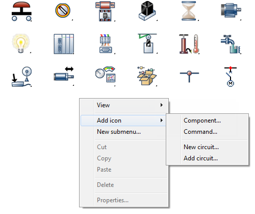

Add a new icon to the menu
  1. Create an AutoCAD Electrical compatible library symbol. For schematic symbols, follow the guidelines regarding the symbol ".dwg" file naming convention and required attributes.
  2. Click Schematic tabOther Tools panelIcon Menu Wizard. Find
  3. On the Select Menu File dialog box, select the menu file (.dat) to modify and click OK.
  4. On the Icon Menu Wizard dialog box, select Add Component to add a new icon to the menu.
    You can alternately select Command, New Circuit, Add Circuit or New Submenu depending on which type of icon you want to add.

  4. In the Icon Menu Wizard dialog box, select Add Component to add a new icon to the menu.
    Note: You can also right-click in empty space and select Add icon Component.
