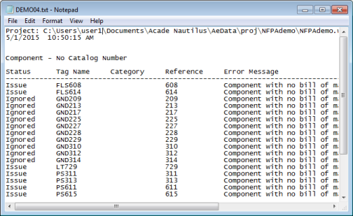

Use this tool to identify and clean up some types of component and wire problems. The report includes the following types of problems:
With this report you can:

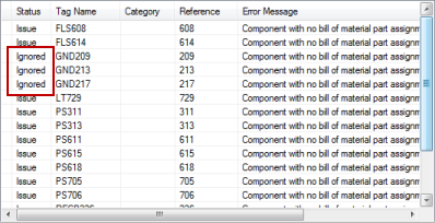

There are a few things to keep in mind regarding errors marked as Ignored:
