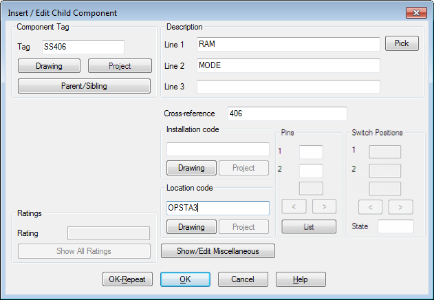

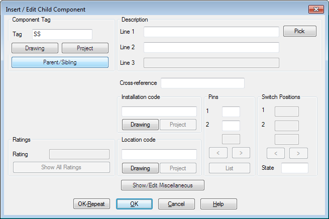

Edit a child contact
. Find
Select component/cable/location box to EDIT:
Select the selector switch on line reference 410
Select component:
Select the bottom sibling contact (3) of the existing switch on line reference 408
AutoCAD Electrical reads the sibling contact and transfers the appropriate annotation to your new switch contact.
The sibling contact information displays on the drawing.
