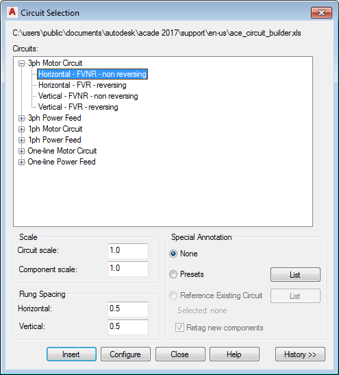

Use Circuit Builder to insert and configure a 3-phase motor circuit.
You now construct a new motor circuit on the extended 3-phase bus.
Insert and configure the circuit

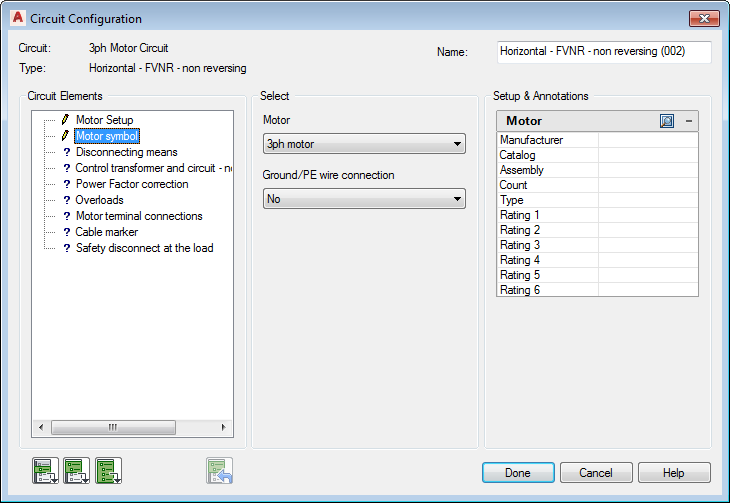

In the Select section, select Motor: 3ph motor,
Ground/PE wire connection: No.

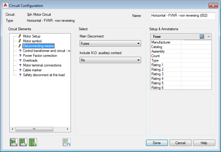

In the Select section, select Main Disconnect: Fuses,
Include N.O. auxiliary contact: No.

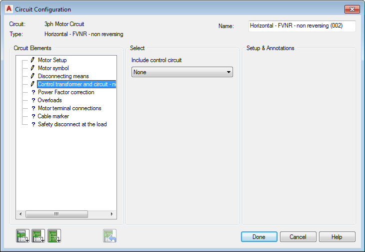

In the Select section, select Include control circuit: None.

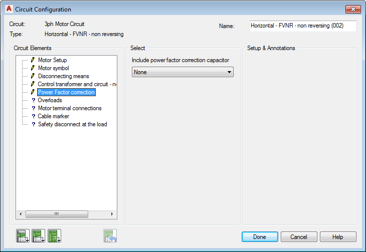

In the Select section, select Include power factor correction capacitor: None.

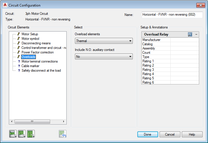

In the Select section, select Overload elements: Thermal,

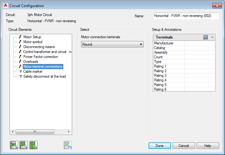

In the Select section, select Motor connection terminals: Round.

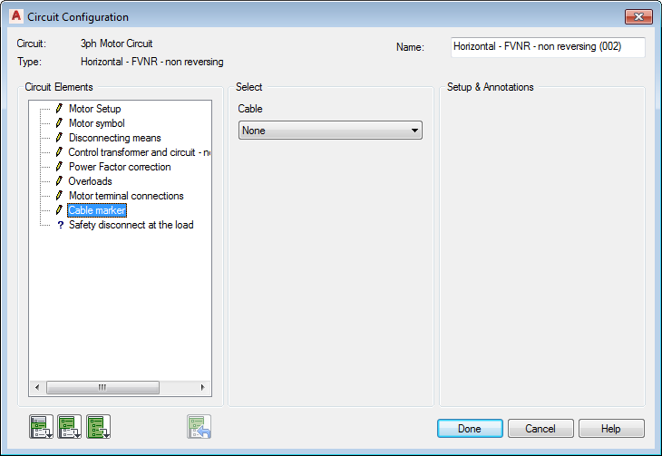

In the Select section, select Cable: None.

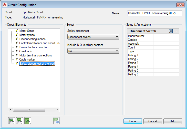

In the Select section, select Safety disconnect: Disconnect switch,
