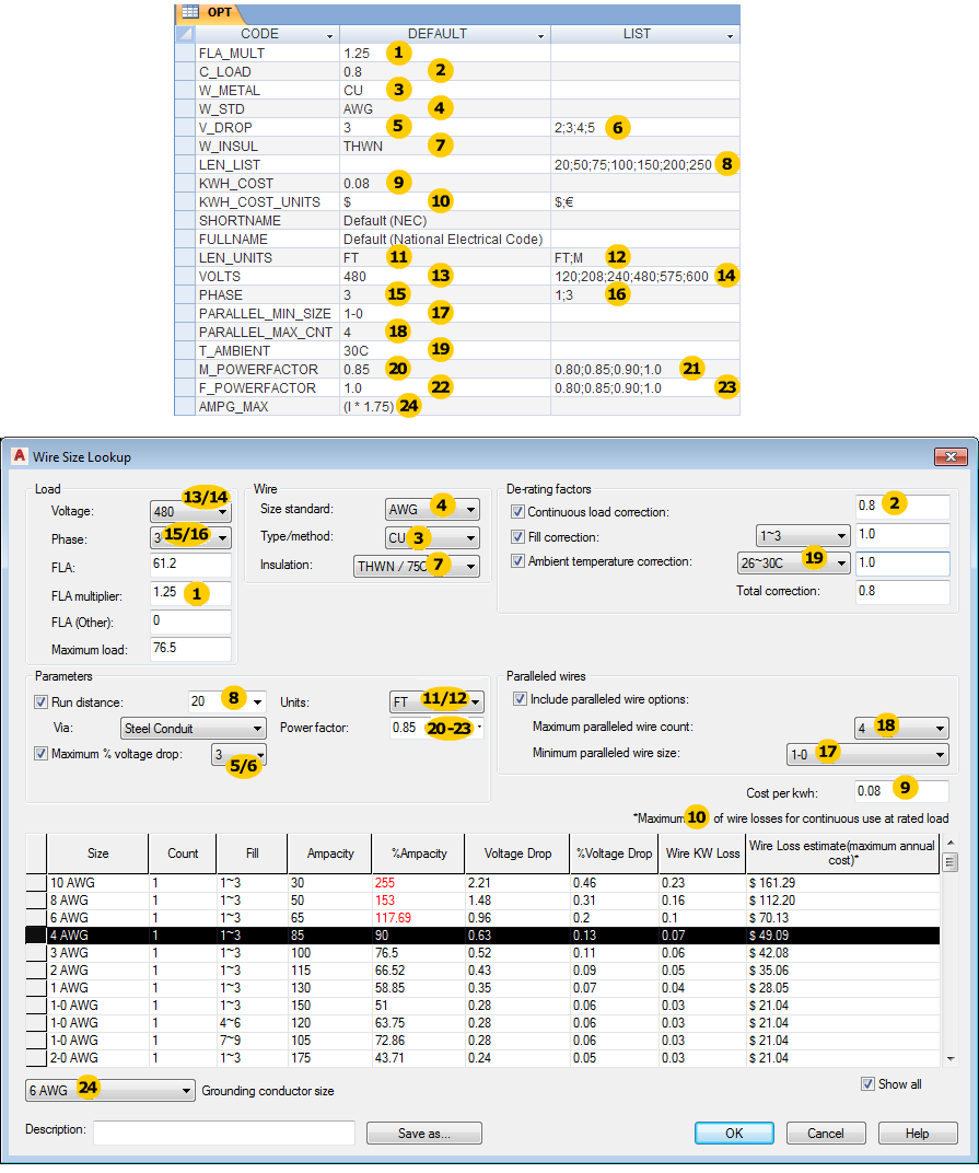

Options tables contain values defining defaults and options lists specific to an electrical standard. For example, default to copper wiring, AWG size standard, and feet for conductor length units.
The OPT table follows this table naming convention:
Name |
Description |
FLA_MULT |
Default full load amps multiplier value used to determine a maximum load. For example, the full load amps for a motor is rated at 10 amps and the FLA_MULT default is set to 1.25. The minimum wire size calculation for the wiring for the motor is based upon an ampacity rating of not 10 amps but 12.5 amps (10 amps x 1.25). The FLA_MULT factor displays in the Select Motor and Wire Size Lookup dialog boxes. |
C_LOAD |
Continuous load correction factor for wire size ampacity de-rating. If the electrical load is anticipated to be a continuous load, a default de-rating factor can be automatically applied to the wire size ampacity calculation. For example, a given electrical code defines the Continuous load correction factor at a value of 0.8. This means that a given wire size that normally has a maximum rated ampacity value of 20 amps is de-rated to a maximum ampacity of 16 amps when the wiring is to power a motor that is expected to be a continuous load. The wire size calculation may need to select the next larger wire size. |
W_METAL |
Default wire metal value used to determine appropriate wire ampacity and wire insulation table names. For example, “CU” to define copper wiring as the default, “AL” to define aluminum wiring as the default. |
W_STD |
Default wire type standard used to determine appropriate wire ampacity and wire insulation table names. For example, “AWG” or “MM2”. |
V_DROP |
Maximum allowable % voltage drop in power wiring. This value can be used to help calculate an appropriate wire size when the wire run distance is also defined. |
W_INSUL |
Default insulation type used to determine the ambient temperature correction factor. |
LEN_LIST |
Wire run distance values for pick list in the Wire Size Lookup dialog box. The run distance is used for estimated voltage drop calculations in the motor or load power wiring. |
LEN_UNITS |
Run distance units for power conductors and values for units pick list in the Wire Size Lookup dialog box. Run distance is used in the estimated voltage drop calculation. Units are either "FT" for feet or "M" for meters. |
KWH_COST |
Unit cost per kWh. This value is used for estimating a maximum annual cost of energy loss in the power wiring for a motor or load, assuming a continuous full load. |
KWH_COST_UNITS |
KWh cost units character used in the Wire Size Lookup dialog box showing the wire loss estimates. For example, “$” for dollar, “€” for euro. |
SHORTNAME |
The code for the electrical standards name for this table. This code is saved in the project .wdp file when the standard is applied to a project. |
FULLNAME |
The full name of the electrical standards name for this table. This value, extracted from all the OPT tables, provides the values for the pick list when setting an Electrical Code Standard for a project from the Project properties: project settings tab. |
LEN_UNITS |
Run distance units for power conductors and values for units pick list in the Wire Size Lookup dialog box. Run distance is used in the voltage drop calculation. |
VOLTS |
Default supply voltage value and values for voltage pick list in the Wire Size Lookup dialog box. |
PHASE |
Default supply phase value and values for phase pick list in the Wire Size Lookup dialog box. For example, “1” for single-phase, “3” for three-phase. |
PARALLEL_MIN_SIZE |
Default value for the minimum wire size when displaying paralleled wire option in the Wire Size Lookup dialog box. For example, “1-0 AWG”. |
PARALLEL_MAX_CNT |
Default value for the maximum number of wire conductors when displaying paralleled wire option in the Wire Size Lookup dialog box. For example, “4” for up to four paralleled wires per phase. |
T_AMBIENT |
Default ambient temperature correction factor. This value is used in wire type sizing. It must match up with one of the temperature de-rating column labels found in the INSUL_* tables. For example, “30C”. |
M_POWERFACTOR |
Default power factor for a motor. This value is used in estimated voltage drop calculations. For example, “0.85”. |
F_POWERFACTOR |
Default power factor for a power feed. This value is used in estimated voltage drop calculations. For example, “0.85”. |
AMPG_MAX |
Defines the expression to calculate the minimum grounding conductor ampacity size. The “I” in the expression represents the motor or load full load amps (FLA). The result of the expression is then applied to the appropriate AMPG table to determine the minimum grounding conductor size. |

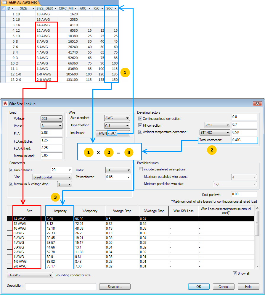

The wire ampacity tables provide the wire conductor sizes, descriptions, and maximum FLA ampacity values based on wire size and standard insulation temperature ratings. This information is used in the following ways:
The wire ampacity tables use the following naming convention:
For example, a table named AMP_CU_AWG_NEC contains the wire ampacity information for copper, AWG sizes, and parallels what is found in the National Electrical Code.
Name |
Description |
SIZE |
Wire size code. This value can be automatically pushed into a wire type layer name. For example, “12”, “250KCMIL”. |
SIZE_DESC |
Wire size description shown on the Wire Size Lookup dialog box. For example, “12 AWG”, “250 KCMIL”. |
CIRC_MIL |
Imperial cross-section value for the wire conductor size. |
60C, 75C, 90C |
Maximum ampacity rating values for the wire conductor size for each of these standard ambient temperature ratings. Additional columns can be added or an existing column can be deleted. For example, if local electrical codes do not support 90C, this field can be removed from the table and does not show up as an option in the Wire Size Lookup dialog box. |

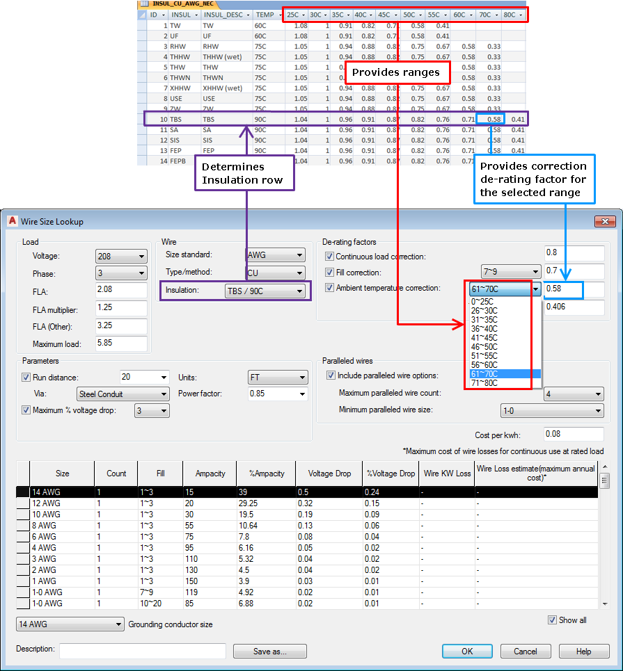

The wire insulation tables provide the option to de-rate wire conductor ampacity based upon expected maximum ambient temperature.
The wire insulation tables use the following naming convention:
For example, a table named INSUL_CU_AWG_NEC contains the wire insulation information for copper, AWG sizes, and parallels values found in the National Electrical Code.
Name |
Description |
INSUL |
Insulation type code. |
INSUL_DESC |
Insulation type description shown on the Wire Size Lookup dialog box. |
TEMP |
Standard, maximum temperature rating for the insulation type. |
25C-80C |
A series of wire conductor ampacity de-rating factor values for maximum ambient temperature. Columns can be added or deleted. For example, if 30C is the minimum ambient temperature rating, the 25C column can be removed. |

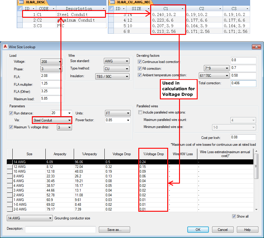

The optional conductor reactance/AC resistance tables provide the reactance and resistance values for wire size based on conduit type. These values are used to calculate the voltage drop percentage in power wiring when a run distance is supplied.

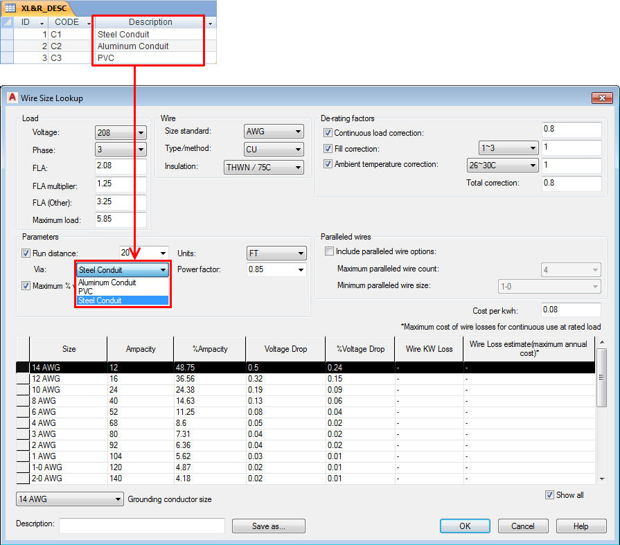

There are two types of tables for this feature. A conduit type description table and the reactance/resistance data tables.
Conduit type description table
The description table, XL&R_DESC, contains the labels used on the Wire Size Lookup dialog box for the conduit or raceway type selection list. The labels also map to the columns in the data tables.
Data tables
The conductor reactance/AC resistance data tables use the following naming convention:
For example, a table named XL&R_CU_AWG_NEC contains the conductor reactance/AC resistance information for copper, AWG sizes, and parallels values found in the National Electrical Code.
Name |
Description |
SIZE |
Wire size code. |
C1-C3 |
A set of reactance and resistance values, semi-colon delimited for the conduit type. The first element is the estimated reactance and the second element is the AC resistance. Note:
see the XL&R_DESC table for the corresponding label for each. Data for additional conduit/raceway types can be added to this table with a corresponding entry added to the XL&R_DESC table. |

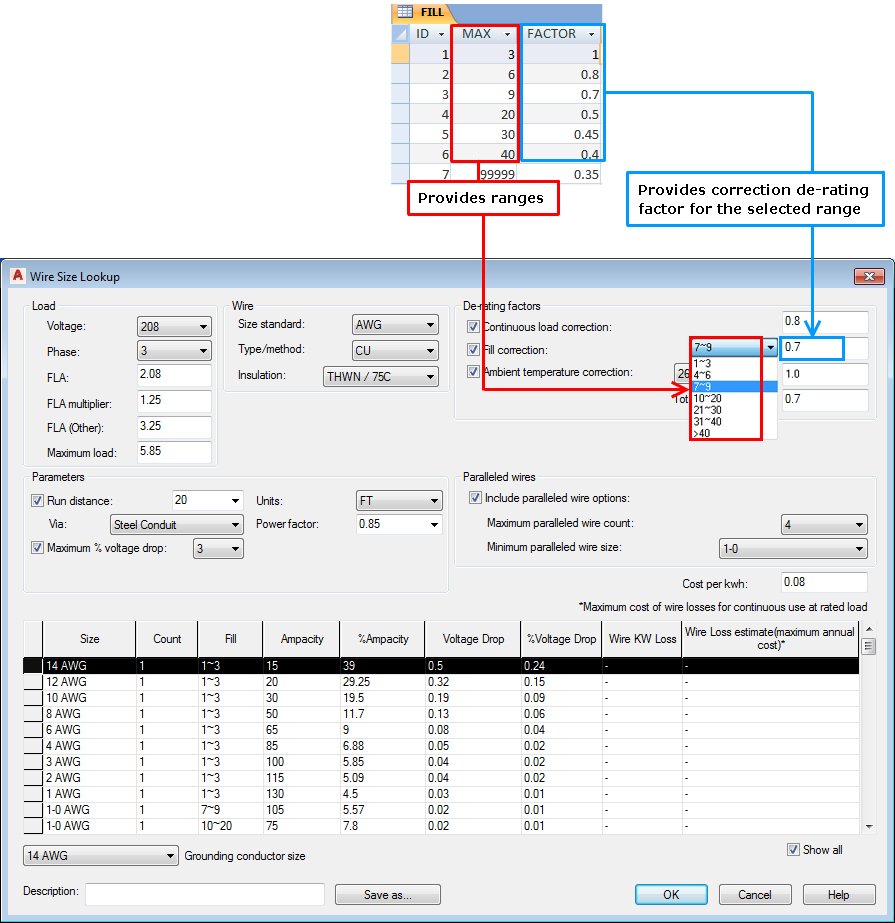

When multiple current carrying wire conductors are in the same conduit, duct, or raceway, the wire ampacity may need to be de-rated. Current carrying wire conductors are defined as power wiring, not ground, neutral, or control wires. The Fill table provides the de-rating factor based on the maximum number of power wire conductors.
The FILL table follows this naming convention:
