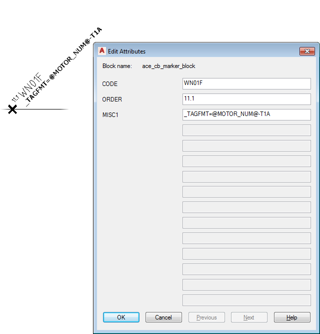

You can include the motor symbol tag number assignment in connected wire number assignments. It requires coordination between the motor symbol insertion and the wire number insertion. The motor symbol must insert before the wire number. The order of insertion is controlled by the ORDER attribute value on the marker blocks within the circuit template drawing. The marker block ORDER attribute value for the motor symbol must be a lower number than the ORDER value of the marker block for the wire number in the circuit template drawing. When the wire number is inserted, the motor tag value can be incorporated in to the wire number.

(c:ace_cb_anno #data 0)(c:ace_cb_save "@MOTOR_NUM@" "TAG1*" nil 1)
The second one, c:ace_cb_save, saves the TAG1 attribute value on the motor in to memory under an index tag of “@MOTOR_NUM@”. This value can be referenced when the subsequent wire number marker blocks are processed.
