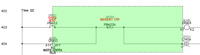

Select Objects:
Window from left to right around the wires as shown and press ENTER
Before you press ENTER, the wires display as dashed lines to indicate that they have been selected. Once you press ENTER the lines display in red indicating that they have been moved to the RED_18AWG wire layer.
