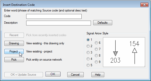

Attach a destination signal
. Find

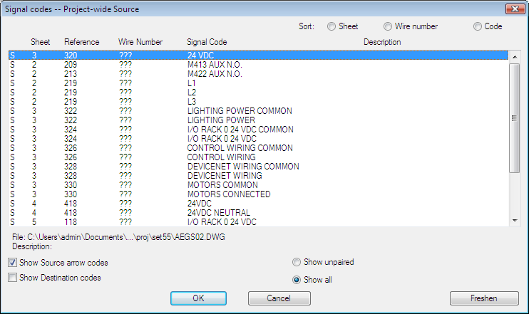

Select wire end for Destination:
Select the top of the hot wire on the schematic on the left side of the drawing at line reference 402 (2)
Code: 24 VDC
Signal Arrow Style: 1
Click OK + Update Source.
The cross-references for your signal insert into the drawing above the hot wire.

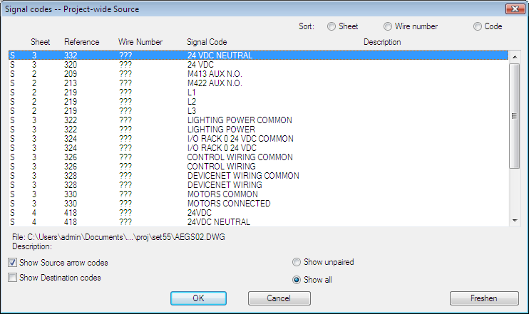

Select wire end for Source:
Select the bottom of the neutral wire at line reference 332 (3)
Code: 24 VDC NEUTRAL
Click OK.
Select the top of the neutral wire at line reference 402 (4)
