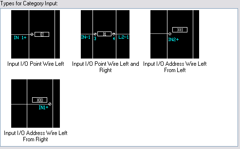

The Select Terminal Information dialog box appears. There are 3 categories for top symbols: Top Input, Top Output, and Top Terminal. Top Input and Top Output are addressable terminals, while the Top Terminal category consists of non-addressable terminals.
The available terminals for that category appear along with any recently used terminals. Each terminal shown is slightly different. It may have an input wire connection terminal or have terminals for both input and output, or it may not have a wire connection.
The selected terminal is assigned to the Terminal Type in the PLC Database File Editor dialog box. AutoCAD Electrical looks at the block to see what attributes come in when the block is inserted. Some of the attributes come in with predefined values that can be overwritten. You will see these predefined values in the grid below the terminal type list.
All seven terminals are assigned at the same time.
