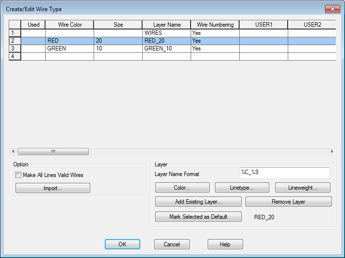

In AutoCAD Electrical, different types of wires represent the type of running pipes that allow water or oil flows from one instrument to another. Start by setting up the type of wires for pipe runs.
Insert wires as pipes
. Find
Wire Color: RED
The Layer Name is automatically created. The name RED_20 is assigned to the wire layer you are creating.
Wire Color: GREEN
Color: Green
Linetype: Hidden2

Select the wire layer GREEN_10. Click OK.
