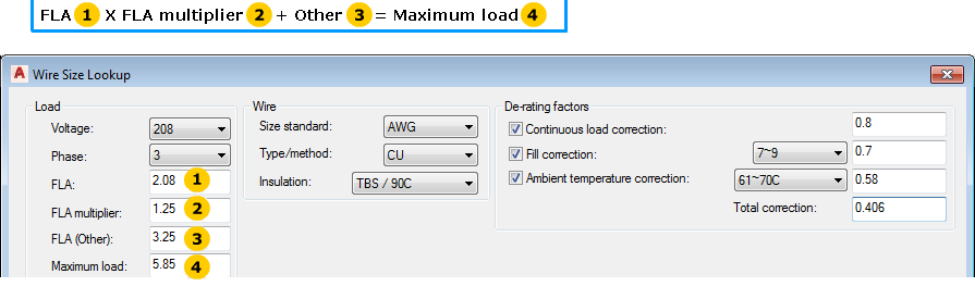

FLA |
Sets the full load amps carried by the wire conductors. |
FLA multiplier |
Sets the value that is multiplied by the FLA value to calculate the maximum load for the wire conductors. |
Other |
Sets the amp value of any additional loads to be combined with the main motor or load and fed from this common branch circuit set of conductors. This value is added to the product of the FLA times FLA multiplier. |

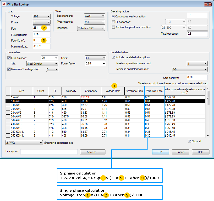

Maximum load |
Displays the calculated maximum load for the conductors. It is based on the FLA (Other) value added to the product of the FLA times the FLA multiplier value. |

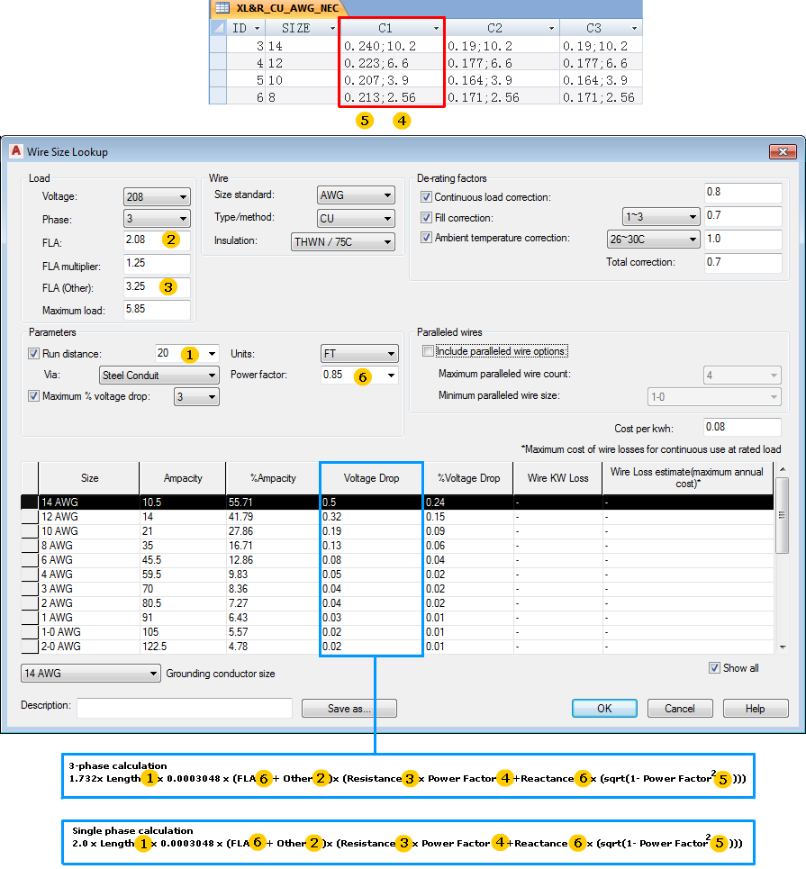

Run distance |
Specifies whether to consider the length of the wire run in calculation of the voltage drop. When Run distance is on, sets the distance. |
Units |
When Run distance is on, sets the distance units. |
Via |
When Run distance is on, sets the type of conduit or raceway which affects the voltage drop calculation. The available types are extracted from the electrical standards database file. |
Power factor |
When Run distance is on, sets the power factor value used to calculate the voltage drop. |

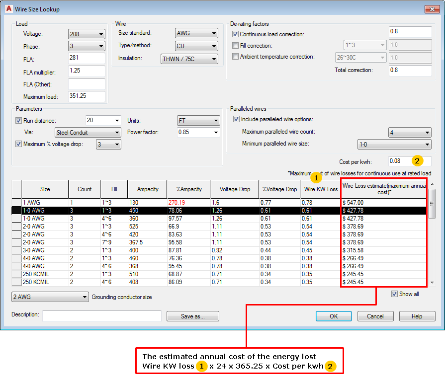

Sets the cost per kilowatt hour used in the wire loss calculations.

Voltage Drop |
The calculated voltage drop from one end of the power run to the other. It can only be calculated if the conductor length is defined. |
%Voltage Drop |
The Voltage Drop value divided by the applied voltage and multiplied by 100. |
Wire KW Loss |
Calculated from the Voltage Drop and FLA. |
Wire Loss estimate (maximum annual cost) |
Maximum cost of wire losses for continuous use at rated load. |
