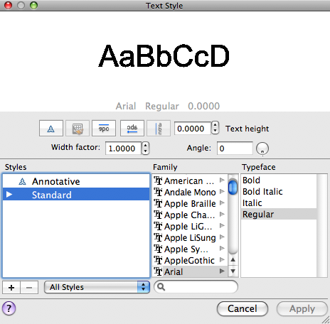

Text Style Dialog Box
Creates, modifies, or specifies text styles.
Summary
Creates, modifies, or sets named text styles.
List of Options
The following options are displayed.
Preview
Displays sample text that changes dynamically as you change fonts and modify the effects.
Effects
Modifies characteristics of the font, such as its height, width factor, and obliquing angle and whether it is displayed upside down, backwards, or vertically aligned.
Annotative ()
Specifies that the text is annotative. Click the information icon to learn more about the annotative objects.
Match Text Orientation to Layout
Specifies that the orientation of the text in paper space viewports matches the orientation of the layout. This option is available when the Annotative option is selected.
Upside Down
Displays the characters upside down.
Backwards
Displays the characters backwards.
Vertical
Displays the characters aligned vertically. Vertical is available only if the selected font supports dual orientation. Vertical orientation is not available for TrueType fonts.
Text Height
Changes the size of the text. This option is available when the Annotative option is cleared.
Paper Text Height
Sets the text height based on the value you enter. Entering a height greater than 0.0 sets the text height for this style automatically. If you enter 0.0, the text height defaults to the last text height used, or the value stored in the drawing template file.
TrueType fonts might be displayed at a smaller height than SHX fonts with the same height setting.
If the Annotative option is selected, the value entered sets the text height in paper space.
Width Factor
Sets the character spacing. Entering a value less than 1.0 condenses the text. Entering a value greater than 1.0 expands it.
Angle
Sets the obliquing angle of the text. Entering a value between -85 and 85 italicizes the text.
Note: TrueType fonts using the effects described in this section might appear bold on the screen. Onscreen appearance has no effect on plotted output. Fonts are plotted as specified by applied character formatting.
Styles
Displays the list of styles in the drawing.
Style names can be up to 255 characters long. They can contain letters, numbers, and the special characters dollar sign ($), underscore (_), and hyphen (-).
Family List
Lists the font family name for all registered TrueType fonts and all compiled shape (SHX) fonts in the Fonts folder.
When you select a name from the list, the program reads the file for the specified font. The file's character definitions are loaded automatically unless the file is already in use by another text style. You can define several styles that use the same font.
Typeface
Specifies font character formatting, such as italic, bold, or regular.
When an SHX font file is selected from the Family list, you can select a Big Font file name from the Asian Set list.
Asian Set
Lists the available Big Font files when an SHX file is selected from the Family list. Select None if you do not want to use a Big Font.
New (+)
Adds a new text style to the Styles list and automatically supplies the name “ stylen” (where n is the number of the supplied style) for the current settings. You can accept the default or enter a name and close the Text Style dialog box to apply the current style settings to the new style name.
Delete (-)
Removes the selected text style.
Note: You cannot remove text styles that are in use by an annotation object or style.
Style List Filter
The drop-down list specifies whether all styles or only the styles in use are displayed in the styles list.
Family Filter
Filters the fonts listed in the Family list.
