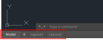

Rename Layout
- Right-click any layout tab, and choose Rename.
Delete Layout
- Right-click any layout tab, and choose Delete.
Rearrange the Layout Tabs
- Click and drag any layout tab to a different location.
Scroll through Layout Tabs
- When there are more layout tabs than can be displayed, click the left and right arrows to the right of the rightmost layout tab to scroll through the available layout tabs.
Next or Previous Layout Tab
- Press
command+] to switch to the next tab or
command +[ to switch to the previous tab.
