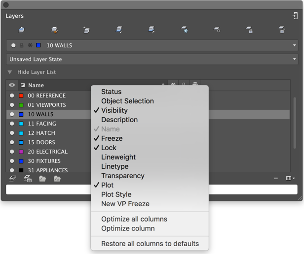

Column Label Shortcut Menu
Column Names
Lists all columns by name. A check mark indicates that the column is included in the display. Click a column name to display or hide the column. VP Freeze, VP Color, VP Linetype, VP Lineweight, and VP Plot Style are available only when a layout viewport is active.
Optimize all columns
Changes the width of all columns to fit the content in each column.
Optimize column
Changes the width of the selected column to fit the content in that column.
Restore All Columns to Defaults
Sets all columns to their default display and width settings.

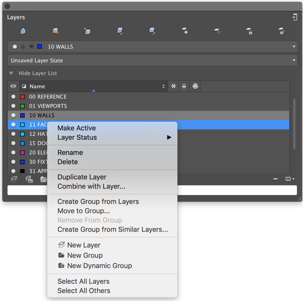

Layer List Shortcut Menu
Make Active
Sets the selected layer as the current layer. (See CLAYER system variable)
Layer Status
Toggles the Freeze, Lock, Freeze in New Viewports, or Prints layer status of the selected layers. The Isolate option isolates the selected layers in the drawing. All layers except those selected, are turned off and locked. (See LAYISO command)
Rename
Renames the selected layer.
Delete
Deletes the selected layer from the drawing. You can delete only unreferenced layers. Referenced layers include layers 0 and DEFPOINTS, layers containing objects (including objects in block definitions), the current layer, and xref-dependent layers.
Note: Be careful about deleting layers if you are working on a drawing in a shared project or one based on a set of layering standards.
Duplicate Layer
Creates a new layer based on the selected layer. The new layer inherits all properties and statuses of the selected layer.
Combine with Layer
Displays the Choose a Layer dialog box which allows you to merge the selected layers to a specified layer. After the layers are merged, the selected layers are removed from the drawing. (See -LAYMRG)
Create Group from Layers
Creates a new layer group and adds the selected layers as references of the layer group.
Move to Group
Displays the Choose a Group dialog box which allows you to add the selected layers as references to a specified layer group.
Remove from Group
Removes the selected layers from the layer group.
Create Group from Similar Layers
Displays the New Dynamic Group dialog box and defines a rule for each of the layer's properties. Name the new dynamic group or modify the rules for the new dynamic group before creating the dynamic group.
New Layer
Creates a new layer. The layer list displays a layer named Layer1. You can edit the name immediately. The new layer inherits the properties of the currently selected layer in the layer list (color, on or off state, and so on).
New Group
Creates a new layer group. The layer list displays a layer group named Group1. You can edit the name immediately.
New Dynamic Group
Displays the New Dynamic Group dialog box and allows you to create a layer group that contains all the layers based on the layer properties specified.
Select All Layers
Selects all layers displayed in the list view.
Select All Others
Selects all other layers in the list view except the currently selected layers.

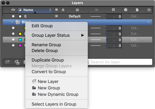

Group Item Shortcut Menu
Edit Group (Applies to dynamic layer groups only)
Displays the New Dynamic Group dialog box and allows you to modify the groups rules.
Group Layer Status
Toggles the Visibility, Freeze, or Lock, Freeze in New Viewports, or Prints layer status of the selected layers. The Isolate option isolates the selected layers in the drawing. All layers except those selected, are turned off and locked. (See LAYISO command)
Rename Group
Renames the selected layer group.
Delete Group
Deletes the selected layer group. You have the option to delete just the layer group, or the layer group and the layers that the group references.
The GROUPLAYERDELETABLE system variable controls the removal behavior of layers referenced by a layer group when it is being deleted.
Duplicate Group
Creates a new layer group based on the selected layer group. The new layer group inherits the references to all the layers of the selected layer group.
Merge Group Layers
Displays the Choose a Layer dialog box which allows you to merge the layers in the selected layer group to a specified layer. After the layers are merged, the selected layers are removed from the drawing. (See -LAYMRG command)
Convert to Group
Creates a layer group from the selected dynamic layer group. When new layers are added or changed, they are no longer automatically added to or removed from the group based on their properties.
New Layer
New Group
New Dynamic Group
Select Layers in Group
Selects all the layers in the selected layer group.
