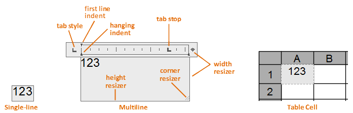

Creates or modifies single-line or multiline text objects.
Depending on the type of text object you are working with, the editor can look different.
Right-click in the editor to display the shortcut menu.

Provides options for changing the behavior of the text editor and provides additional editing options.
Controls display of the In-Place Text Editor and the text within it. When unchecked, text that would otherwise be difficult to read (if it is very small, very large, or is rotated) is displayed at a legible size and is oriented horizontally so that you can easily read and edit it.
When this option is checked, the MTEXTFIXED system variable is set to 0. Otherwise, MTEXTFIXED is set to 2.
Controls display of the Text Formatting toolbar. This option sets the MTEXTTOOLBAR system variable. (Not available for single-line text.)
Expands the Text Formatting toolbar to show more options. (Not available for single-line text.)
Controls the display of the ruler. (Not available for table cells and single-line text.)
Right-click the ruler to display a shortcut menu.
