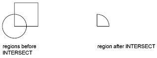

Creates a 2D region from selected overlapping regions.
With INTERSECT, you can create a 2D region object from the overlapping area of two or more existing regions. You can select only regions for use with INTERSECT.
You can intersect regions only with other regions that are on the same plane. However, you can perform simultaneous INTERSECT operations by selecting sets of regions on different planes. Separate, intersected regions are then produced on each plane.
