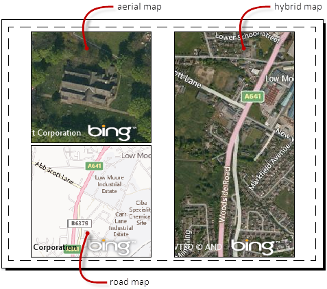

You can display the map as a satellite image (aerial style map) or as a vector image (road style map). You can also display the map as a hybrid of the aerial and road styles. If the drawing area is divided into multiple viewports, each viewport can have a different style of map.
