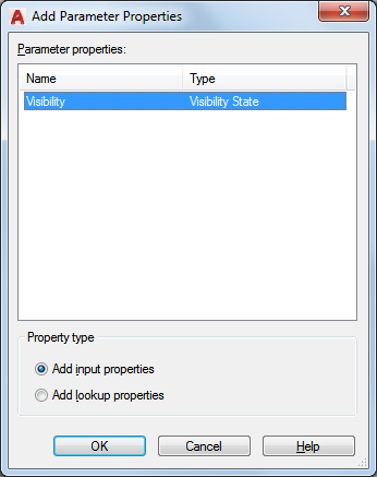

Adds parameter properties to a lookup table.
The following options are displayed.
Displays a list of parameters not yet added to the lookup table. Select a parameter and click OK to add it to the lookup table.
Specifies the type of property to add to the lookup table.
Displays the available custom properties in parameters you’ve already added to the block definition.
Displays the available lookup property parameters that can be added to the lookup table.
