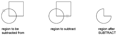

Select the objects that you want to keep, press Enter, then select the objects that you want to subtract.
Objects in the second selection set are subtracted from objects in the first selection set. A single new region is created.
