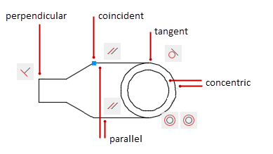

You can apply geometric constraints to associate 2D geometric objects together, or specify a fixed location or angle.
For example, you can specify that a line should always be perpendicular to another one, that an arc and a circle should always remain concentric, or that a line should always be tangent to an arc.

With some constraints, you can specify constraint points on objects instead of specifying the objects themselves. Constraint points on objects are similar to object snaps, but the locations are limited to endpoints, midpoints, center points, and insertion points. For example, a coincident constraint can restrict the location of the endpoint of one line to the endpoint of another line.
The following glyph displays on an object as your cursor rolls over it. In this case, it indicates that the next constraint will be applied to the left endpoint of the horizontal line.
Once constraint points are applied to an object, you can display markers that indicate the constrained points by rolling your cursor over the constraint icon.
The icons associated with constraints can include small variations that provide information about how the constraint has been applied.
The fix, horizontal, and vertical constraint icons indicate whether the constraints are applied to an object or a point. For example, a Fix constraint that is applied to an point rather than the object includes a small circle in the icon:
