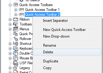

 Delete a Quick Access Toolbar
- In the Customize tab, Customizations In <file name> pane, click the plus sign (+) next to the Quick Access Toolbars node to expand it.
- Right-click the Quick Access toolbar you want to delete and click Delete.
- Click Apply.

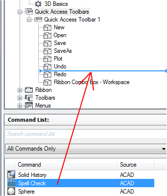

 Add a Command or Control (CUI Editor)
- Click the plus sign (+) next to the Quick Access toolbar that you want to modify.
- Under the Command List pane, drag the command or control you want to add to the Quick Access Toolbar under the Customizations In <file name> pane.
 A visual indicator bar is displayed to indicate the location where the command or control will be added when you release the pointing device button.
- Once the visual indicator bar is in the location you want to insert the command or control, release the pointing device button.
- Click Apply.

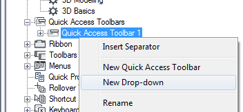

 Add a Drop-down
- Right-click the Quick Access toolbar which you want to add a drop-down to. Click New Drop-down.
 A new drop-down (named New Drop-down) is added to the bottom of the Quick Access toolbar.
- Right-click the new drop-down. Click Rename and enter a new name. Note: You can click, wait, and click again over a drop-down name to edit its name in-place in the Customizations In <file name> pane.

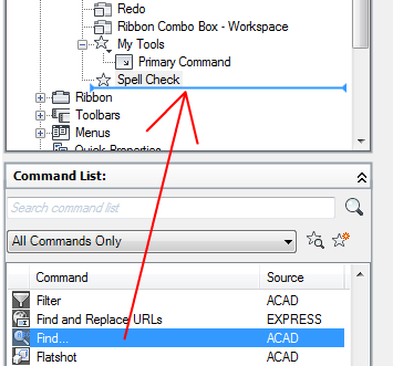

- Drag the drop-down under the Quick Access toolbar to the position where you want it placed. Release the pointing device button to reposition the drop-down. Use the visual indicator bar that is displayed to help specify the location for the drop-down.
- Under the Command List pane, drag the command or control you want to add to the drop-down menu under the Customizations In <file name> pane.
 A visual indicator bar is displayed to indicate the location where the command or control will be added when the pointing device button is released.
- Once the visual indicator bar is in the location where you want to insert the command or control, release the pointing device button.
- If the drop-down will use the Split behavior, add a command to the Primary Command node under the drop-down to set the command for the main button.
- Click Apply.

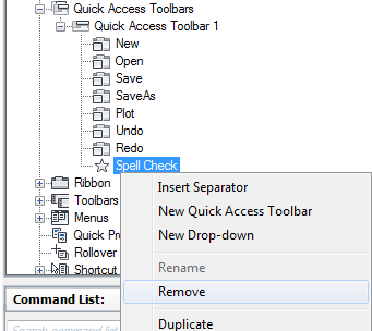

 Remove a Command or Control (CUI Editor)
- Click the plus sign (+) next to the Quick Access toolbar from which you want to remove a command or control.
- Right-click the command or control you want to remove and click Remove.
- Click Apply.
