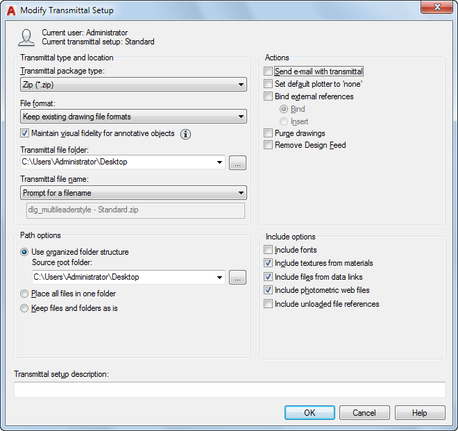

Changes transmittal package settings such as package type, file format, location, and filename.
The following options are displayed.
Specifies the type and path to the transmittal package created.
Specifies the type of transmittal package created.
| Transmittal Package Type | Description |
| Folder | Creates a transmittal package of uncompressed files in a new or existing folder. |
| Zip | Creates a transmittal package of files as a compressed ZIP file. To restore the files to the folder location that you specify, you need a decompression utility such as the shareware application PKZIP or WinZip. |
Specifies the file format to which all drawings included in a transmittal package will be converted. You can select a drawing file format from the dropdown list.
Specifies whether drawings are saved with scale representations for annotative objects.
Annotative objects can have multiple scale representations. Annotative objects are decomposed and scale representations are saved to separate layers, which are named based on their original layer and appended with a number.
Specifies the location in which the transmittal package is created. To specify a new location, click Browse and navigate to the location you want.
If this field is left unchanged, the transmittal file is created in the folder containing the first specified drawing file. In a sheet set context, the transmittal file is created in the folder containing the sheet set data (DST) file. (Not applicable to AutoCAD LT.)
Specifies the method for naming the transmittal package. This option is not available if the transmittal package type is set to Folder.
| Transmittal File Type Property | Description |
| Prompt for a File Name | Displays a standard file selection dialog box where you can enter the name of the transmittal package. |
| Overwrite if Necessary | Uses a logical default file name. If the file name already exists, the existing file is automatically overwritten. |
| Increment File Name if Necessary | Uses a logical default file name. If the file name already exists, a number is added to the end. This number is incremented each time a new transmittal package is saved. |
Provides options for organizing the files and folders that are included in the transmittal package.
Duplicates the folder structure for the files being transmitted. The root folder is the top-level folder within a hierarchical folder tree.
The following considerations apply:
This option is not available if the transmittal package is saved to an Internet location.
Defines the source root folder for relative paths of drawing-dependent files, such as xrefs.
The source root folder also contains the sheet set data (DST) file when a sheet set is transmitted. (Not applicable to AutoCAD LT.)
All files are installed to a single, specified target folder when the transmittal package is installed.
Preserves the folder structure of all files in the transmittal package, facilitating ease of installation on another system. This option is not available if the transmittal package is saved to an Internet location.
Provides options for organizing the actions that can be associated with the transmittal package.
Launches the default system email application when the transmittal package is created so that you can send an email that includes the transmittal package as an attachment.
Changes the printer/plotter setting in the transmittal package to None. Your local printer/plotter settings are usually not relevant to the recipient.
Binds all AutoCAD drawing file (DWG) external references to the files to which they were attached.
Binds the selected DWG external reference to the current drawing.
Binds the DWG external reference to the current drawing in a way similar to detaching and inserting the reference drawing.
Performs a purge operation on each of the specified drawings to reduce the file size, if possible.
Removes the association to any design feed data for the specified drawings.
Provides a means for including additional options with the transmittal package.
Includes any associated font files (TTF and SHX) with the transmittal package.
Includes textures from materials that are attached to objects or faces.
Adds external files referenced by a data link to the transmittal package.
Includes photometric web files that are associated with web lights in the drawing.
Includes all unloaded external references, images, and underlays. The unloaded file references are listed in the Files Tree and Files Table and report under their appropriate category.
Enter a description for the transmittal setup. This description is displayed in the Create Transmittal dialog box below the list of transmittal file setups. You can select any transmittal setup in the list to display its description.
