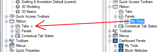

Create a Ribbon Panel
- In the Customize tab, Customizations In <file name> pane, click the plus sign (+) next to the Ribbon node to expand it.
- Right-click the Panels node. Click New Panel.
 A new panel (named Panel1) is placed at the bottom of the Panels node.
- Right-click Panel1. Click Rename and enter a new panel name.

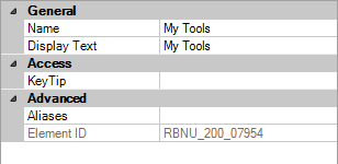

- Select the new panel, and update its properties in the Properties pane: - In the Display Text box, enter the text you want to display for the title of the panel when it is displayed on the ribbon.
- In the KeyTip box, enter the characters to access the ribbon panel from the keyboard when Alt is pressed.
- In the Aliases box, enter an alias for the ribbon panel.
- Click Apply.

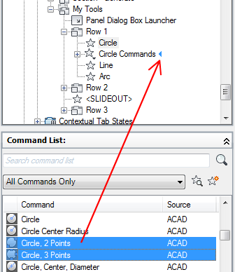

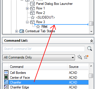

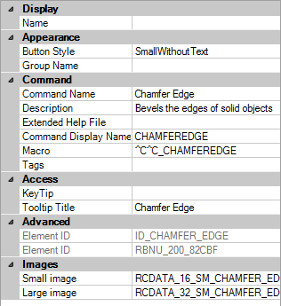

 Add a Command
- Click the plus sign (+) next to the Panels node to expand it.
- Click the plus sign (+) next to the ribbon panel where you want to add a command.
- Click the plus sign (+) next to the rows, sub-panels, or drop-downs to get to the location you want to add a command.
- Drag and drop a command from the Command list to a row, sub-panel, or drop-down on the panel.
- In the Properties pane, change the properties of the command you added.
- Click Apply.

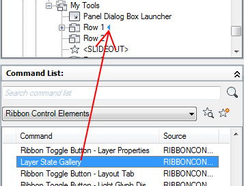

Add a Control
- Click the plus sign (+) next to the ribbon panel where you want to add a control.
- Create a new row for the control if you need to, or click the plus sign (+) next to the row where you want to add a control.
- In the Command List pane, Categories list, select Ribbon Control Elements.
 The Command list displays the list of ribbon control elements only.
- Drag and drop a control from the Command list to a row in the ribbon panel.
- Click Apply.

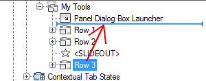

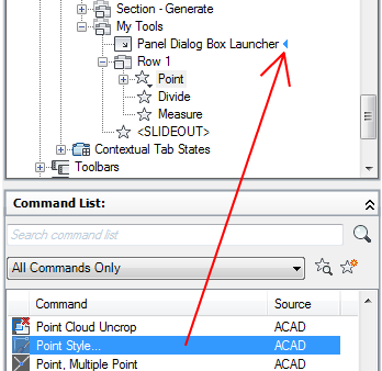

Assign a Command to the Panel Dialog Box Launcher
- Click the plus sign (+) next to the ribbon panel where you want to assign a command to its Panel Dialog Box Launcher node.
- Drag a command from the Command list to Panel Dialog Box Launcher on the panel.
- Click Apply.

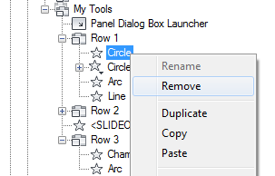

 Remove a Command or Control
- Click the plus sign (+) next to the ribbon panel where you want to remove a command or control.
- Click the plus sign (+) next to the rows, sub-panels, or drop-downs to get to the location you want to remove a command or control.
- Right-click the command or control that you want to remove. Click Remove.
- Click Apply.

 Add a row
- Right-click the ribbon panel to which you want to add a row. Click New Row.
- Click Apply.

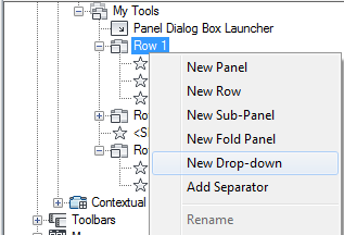

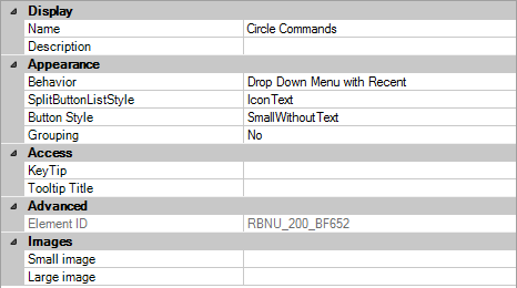

Create a Drop-down in a row
- Click the plus sign (+) next to the ribbon panel where you want to add a drop-down.
- Right-click the row to which you want to add a drop-down. Click New Drop-down.
 A new drop-down (named New Drop-down) is created in the last position of the row.
- Right-click the new drop-down. Click Rename and enter a new name.
- From the Command List pane, drag and drop the commands that you want to add to the new drop-down.
-  Adjust the properties of the drop-down as desired to control the appearance of the drop-down and the commands under the drop-down.
- If the drop-down will use the Split behavior, add a command to the Primary Command node under the drop-down to set the command for the main button.
- Click Apply.

Set the Size of a Command or Drop-down
- Click the plus sign (+) next to the ribbon panel which has the command or drop-down for which you want to set the size.
- Click the plus sign (+) next to the row or sub-panel that has the command or drop-down for which you want to set the size. If you need to, continue expanding rows, sub-panels, and drop-downs to get to the command or drop-down.
- Select the command or drop-down for which you want to set the size.
- In the Properties pane, Button Style box, click the down arrow and select Large With Text (Vertical), Large With Text (Horizontal), SmallWithText, SmallWithoutText, or LargeWithoutText.
- Click Apply.
Set the Button Style of a Drop-down
- Click the plus sign (+) next to the ribbon panel where you want to change the style of a drop-down.
- Click the plus sign (+) next to the row or sub-panel that contains the drop-down you want to change. If you need to, continue expanding rows and sub-panels to get to the drop-down.
- Select the drop-down that you want to change, and update its properties in the Properties pane: - In the Behavior box, click the down arrow and select Drop Down Menu with Recent, Drop Down Menu, Split with Recent, Split, or Split with Recent (Static).
- In the Split Button List Style box, click the down arrow and select Icon, Icon and Text, and Descriptive.
- Click Apply.

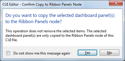

Copy a Toolbar to a Ribbon Panel
- In the Customize tab, Customizations In <file name> pane, click the plus sign (+) next to the Toolbars node to expand it.
- Right-click the toolbar that you want to copy and convert to a ribbon panel. Click Copy to Ribbon Panels.
- In the CUI Editor - Confirm Copy to Ribbon Panels Node dialog box, click Yes. The copied toolbar is placed under the Ribbon  Panels node. Panels node.
- Click Apply.

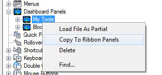

Copy a Dashboard Panel to a Ribbon Panel
- In the Transfer tab, Customizations In <file name> pane on the right side, click the Open Customization File button.
- In the Open dialog box, Files of Type drop-down list, select Legacy Customization Files (*.cui).
- Browse to and select the customization (CUI) file that contains the dashboard panels you want to copy to ribbon panels. Click Open.
- Click the plus sign (+) next to the Dashboard Panels node to expand it.
- Right-click over the dashboard panel you want to copy and convert to a ribbon panel. Click Copy to Ribbon Panels.
 The copied dashboard panel is placed under the Ribbon  Panels node. Panels node.
- Drag the new ribbon panel from the Customizations In <file name> pane on the right side to the Panels node of a loaded CUIx file in the Customizations In <file name> pane on the left side.
- Click Apply.
