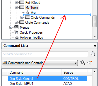

Add a Control
- In the Customize tab, Customizations In <file name> pane, click the plus sign (+) next to the Toolbars node to expand it.
- Click the plus sign (+) next to the toolbar to which you want to add a control.
- In the Command List pane, Categories drop-down list, select Toolbar Control Elements.
 The Command List pane displays a list of toolbar control elements only.
- In the Command list, drag the control to the toolbar you want to add it to in the Customizations In <file name> pane.
 Tip: You can also drag and drop a control from the Command List pane onto the toolbar’s preview in the Toolbar Preview pane.
- Click Apply.

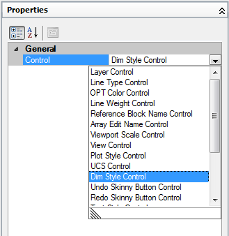

Switch a Control in a Toolbar
- Click the plus sign (+) next to the toolbar to which you want to switch a control.
- Click the control element under the toolbar.
- In the Properties pane, Control box, click the down arrow to display a list of all available toolbar controls.
- Select a toolbar control to replace the original control with.
- Click Apply.
 Reposition a Command or Control
- Click the plus sign (+) next to the toolbar that contains the command or control you want to reposition to expand it.
- Drag the command or control you want to reposition to the new location on the toolbar.
 While dragging the command or control, use the visual indicator to specify the new position of the command or control.  Tip: You can also reposition commands and controls by dragging them in the Toolbar Preview pane for a selected toolbar.
- Release the pointing device button to reposition the command or control.
- Click Apply.

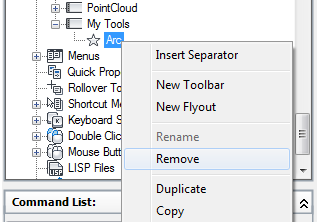

Remove a Command or Control
- Click the plus sign (+) next to the toolbar that contains the command or control you want to remove.
- Right-click the command or control you want to remove. Click Remove.
 Tip: You can also remove a command or control in the Toolbar Preview pane by dragging and dropping the command or control outside of the preview.
- Click Apply.
