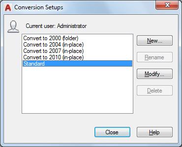

Creates, renames, modifies, and deletes conversion setups.
Displays a list of previously saved conversion setups as well as the default setup; Standard.
Opens the New Conversion Setup dialog box, where you can add a new conversion setup based on an existing conversion setup.
Renames a conversion setup that appears in the list. Only conversion setups that you have created can be renamed. The Standard conversion setup cannot be renamed.
Displays the Modify Conversion Setup dialog box, in which you can specify options for the selected drawing conversion.
Removes the currently highlighted conversion setup. The Standard conversion setup cannot be deleted.
