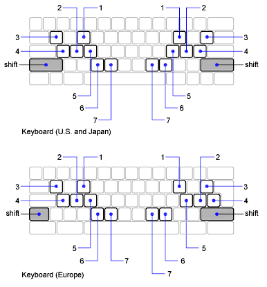

Several temporary override keys are available also for specific running object snaps.
The keys in the following illustration are the default keys, but you can change key assignments and add your own as needed.
| Hold down Shift and one of the temporary override keys in the illustration: | |||
| 1 | Suppresses the Endpoint object snap | 5 | Suppresses all snapping and tracking |
| 2 | Enforces object snap selection | 6 | Suppresses the Center object snap |
| 3 | Suppresses object snap tracking | 7 | Suppresses the Midpoint object snap |
| 4 | Suppresses all object snaps | ||
