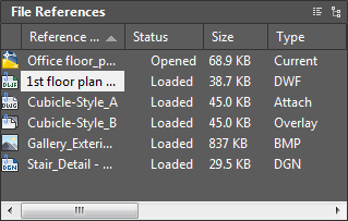

Lists all file references in the current drawing.

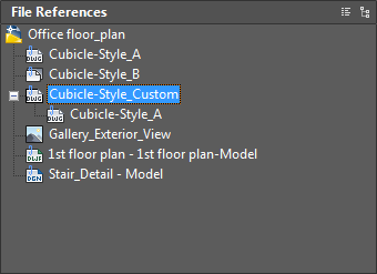

You can display these file references in a list or in a tree structure.
The following options are displayed.
The listed information includes the reference name, status, file size, file type, creation date and saved path.
The reference name column always displays the current drawing as the first entry, followed by additional attached files that are listed in the order they were attached.
The status of the referenced file:
The size of the attached file reference.
The file type of the referenced file. Drawing (Xref) files display as attachments or overlays, raster images show their file format; and DWF, DWFx, DGN, and PDF underlays are listed as their respective file types.
The date when the referenced file was created or last saved.
Displays the path that is saved with the drawing when the referenced file is attached.
The top level of the tree view always shows the current drawing. Referenced files appear at the next level. Referenced files that contain their own nested file references can be opened to show deeper levels. When making selections in tree view, only one file reference can be selected at a time.
