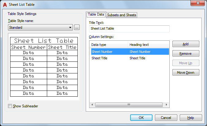

The Edit Sheet List Table Settings dialog box gives you access to all the settings found on the Insert Sheet List Table dialog box.
The following options are displayed.
Displays options for the table style.
Specifies the table style to be used for the table. The Browse button displays the Table Style dialog box.
Displays a sample of the currently selected table style.
When checked, displays the names of the subsets, dividing the sheet list table into sections.
Displays options for the table data.
Specifies the name of the title of the sheet list table.
Displays a list of the column definitions in the sheet list table. Each line in the list represents a column. The top-to-bottom order of the list represents how the columns will be displayed in the table (left to right).
Selecting a column definition and then clicking on an entry in the Data Type column displays a list. From the list, you can change the type of information that is going to be displayed in the columns of the sheet list table.
Allows you to change the title text for each column in the sheet list table.
Adds a sheet number column to the sheet list table.
Removes the selected column from the sheet list table. If you accidentally remove a column, you can add a new Sheet Number column and then change its data type from the data type list.
Moves the selected column up in the column list and to the left in the sheet list table.
Moves the selected column down in the column list and to the right in the sheet list table.
