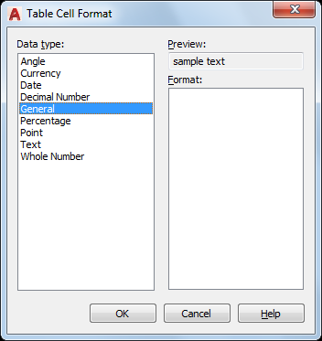

The options displayed here change based on the selected data type and format you select.
The following options are displayed.
Displays a list of data types (Angle, Date, Decimal Number, and so on) that you can format for table rows.
Displays a preview of the option you selected in the Format list.
Depending on the data type you select, displays a list of relevant format types. For example, if you selected Angle as the data type, options such as Decimal Degrees, Grads, Radians, and so on are displayed.
For Angle, Decimal Number, and Points data types only, sets the precision for applicable formats. For example, if you select Angle as the data type and Radians as the format type, options such as Current Precision, 0.0r, 0.00r, 0.000r, and so on are displayed.
For a Point data type only, displays a list of options (comma, semicolon, or colon) that you can use to separate list items.
For Currency data types only, displays a list of currency symbols that you can use.
In Currency data types, places the currency symbol after the number. In the Percentage data types, places the percent symbol after the number.
For Currency data types only, lists options for displaying negative numbers.
For a Point data type only, filters X, Y, or Z coordinates.
For Angle, Decimal Number, Point, and Whole Number data types only, opens the Additional Format dialog box, where you set additional formatting options for table cells.
For the Date data type only, displays a list of date display options for the date option you selected in the Format field. Click a date in the Format field to see an example.
