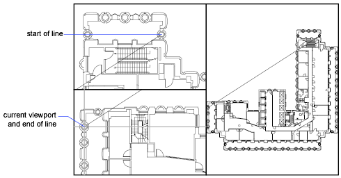

To Draw Across Two Model Space Viewports
 In a large drawing, you can use this method to draw a line from a detail in one corner to a detail in a distant corner.
- Start the line in the current viewport.
- Make another viewport current by clicking within it, and then specify the second endpoint of the line.
