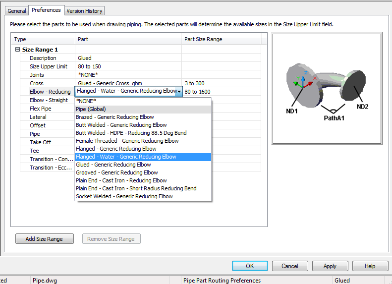

Pipe Part Routing Preferences
Basic
Dimensions
Routing Preference
click
A pipe part routing preference includes one or more size ranges for pipe parts and fittings, such as elbows, tees, laterals, and transitions. The software organizes the size ranges based on nominal pipe diameters. You can use pipe parts and fittings in a specified size range as you lay out the pipe run. The following example shows the routing preferences for Glued. Notice that the available Pipe parts are organized based on material type for US Imperial and US Metric profiles.

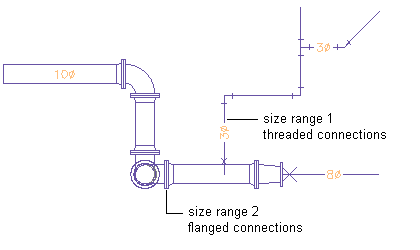

Multiple size ranges provide more flexibility in your piping designs. For example, assume a design specification for a chilled water system requires commercial steel pipe with threaded connections for all pipe sizes 3'' and lower. The system also specifies commercial steel pipe with 150 class, weld neck, flange connections for pipe sizes 3 1/2'' and higher.
When you configure a routing preference for a particular specification, the appropriate fittings are automatically inserted into the piping layout. Auto layout can generate different routing solutions, and prompts you to select the best alternative.
Pipe run drawn using a particular routing preference (Top view, Mechanical - Pipe by Size display configuration)
