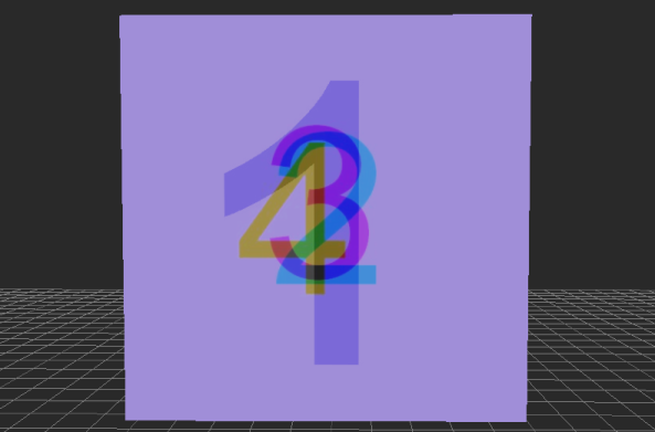

Sample Output: This screenshot was taken after running the Python program, and importing the resulting .fbx file in Autodesk MotionBuilder.

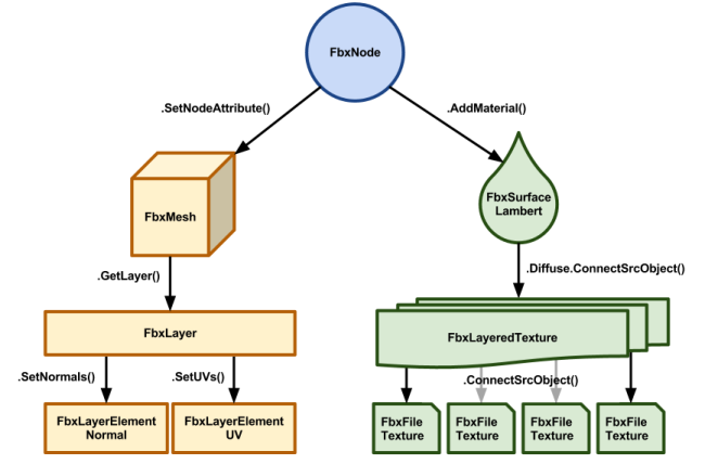

Program Summary: The Python program below creates a scene and exports it to a .fbx file. This scene contains a planar mesh textured using an instance of FbxLayeredTexture. This instance of FbxLayeredTexture is composed of four additively blended instances of FbxFileTexture. The FbxLayeredTexture is connected to the diffuse property of an instance of FbxSurfaceLambert. As illustrated by the following diagram, this instance of FbxSurfaceLambert is added to the FbxNode's list of materials.
The planar FbxMesh is set as the FbxNode's attribute. The normal values and UV coordinates for this mesh are set within its 0th FbxLayer using FbxLayerElementNormal and FbxLayerElementUV. The material is bound to the planar polygon when FbxMesh.BeginPolygon() is called with '0' as a parameter. This 0 refers to the (only) material contained in the parent FbxNode's list of materials, i.e. FbxSurfaceLambert mentioned previously.
