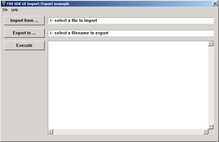

Project Organization
The ImportExport project is located at <yourFBXSDKpath>\examples\UI Examples\importexport\.
ImportExport has two source files:
| Source file |
Description |
| ImportExport.cpp |
Platform-independent functions to convert files from one FBX-supported file format
to another. The function with the main logic is ImportExport().
| UI.cpp |
User interface to ImportExport(). The user interface code depends on the platform for which you downloaded the FBX
SDK. We won’t look at this source file.
