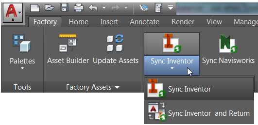

Sync Inventor
Factory tab Sync Workflows panel Sync Inventor .
When you select one of the two Inventor Sync options, you create a 3D Inventor Factory layout from a 2D AutoCAD drawing. During the sync process:
  • Any 2D assets, and chainable assets from AutoCAD are automatically populated with their 3D equivalents in the new layout.
  • In Inventor, a 2D DWG overlay is created and overlaid onto the factory floor.
  • In the Inventor browser, the DWG overlay node appears with the same name as the original 2D drawing and is represented with the icon, indicating the link between the 2D drawing and the new Inventor layout.
  • Any point cloud data attached to the AutoCAD file appears.
When you select Sync Inventor, the Inventor 3D model remains open in Inventor after the sync is complete. The AutoCAD 2D drawing closes, but AutoCAD remains open.
Select Sync Inventor and Return to automatically close the Inventor 3D model after the sync finishes. The AutoCAD 2D drawing reopens and remembers where you left off in your drawing so that you can quickly get back to work in AutoCAD.

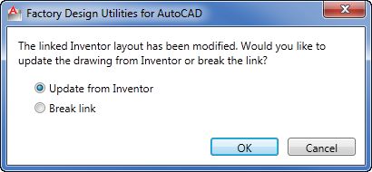

The following dialog appears when opening an AutoCAD 2D drawing whose linked Inventor Factory layout has been revised. Click OK to update the drawing with the changes from the 3D layout.
