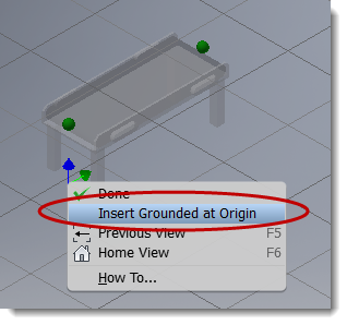

  2. In the Insert Model dialog box, browse to the folder location, select the file to insert into the layout, and select Open. The model appears and follows the cursor movement.
  3. Press the right mouse button and select Insert Grounded at Origin.
  4. Right-click again and select Done to end the insert command.
