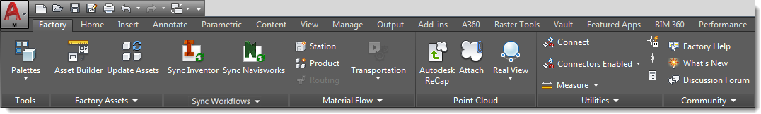

The Factory Design user interface is located on the
Factory tab and laid out with panels named
Tools,
Factory Assets,
Sync Workflows,
Material Flow,
Point Cloud,
Utilities, and
Community. A blend of Factory and standard AutoCAD panels create the default Factory working environment.
