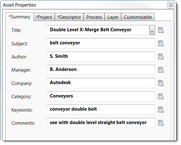

  1. On the Asset Builder tab, in the Author panel, click Asset Properties to open the Properties window.
  2. Enter Summary information to help you search for this asset in the Asset Browser.
    Note: The lightbulb icon that appears next to each field determines if the property value appears on the block in AutoCAD:
    Click the icon to turn on the display. Leave the icon turned off to hide the display in AutoCAD.
    These icons also appear for the Project and Descriptor fields, and for the Value field on the Customizable tab.
