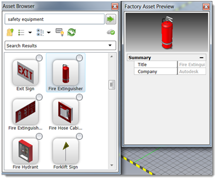

The Asset Browser provides access to System Assets, User Assets, Cloud-based Assets, and asset search results.

| Preview Assets |
Right-click an asset in the Asset Browser and click Preview from the pop-up context menu to see the asset in an enlarged 3D view. Press and hold the left mouse button as you move your mouse to dynamically rotate the asset in the Preview window. You can also use the scroll wheel on your mouse to dynamically zoom in and out.

| Preview | Displays a thumbnail image of the asset in a separate window. |
