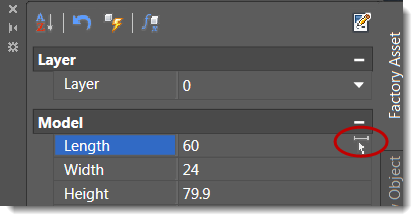

The Factory Properties browser becomes populated with asset data when a parameterized asset is selected in a factory layout assembly.
If a property value is derived from a key parameter expression included in the asset properties definition, you can hover your mouse over the value to view the expression. For example, "The height is 70in" might appear in the asset description; hovering over the field shows that the expression used to define the description is "=The height is <height>".
When updating a distance measurement (for example, height, width, or length), you can either type the value in the field or click the Measure icon to define the distance by selecting two points.

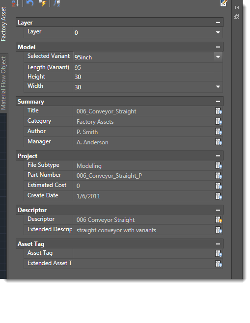

Information is organized in the following categories. If a field is grayed out, the value cannot change. If an asset is not defined for a category, the category does not display.
Update. To override defined variants with a new value, click
Enable Variant Controlled Parameters to activate the variant field for editing. You can update multiple assets at the same time by selecting them and then updating the measurements in the browser. If the selected assets have different values for a specific parameter at the time you select them, *VARIES* appears in the parameter field. To set the parameter to the same measurement for all the selected assets, replace the word VARIES with the new value and click Update.
