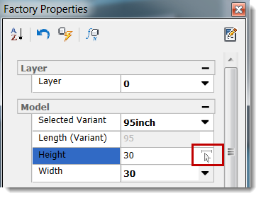

When updating a distance measurement (for example, height, width, or length), you can either type the value in the field or click the Measure icon to define the distance by selecting two points.

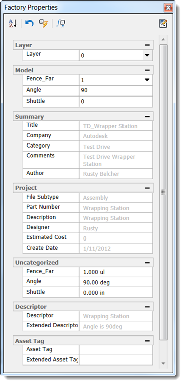

Factory Properties information is organized in the following categories:
- Layer: The layer name of the selected asset. If multiple assets are selected, the layer name appears as
*VARIES*. Click to the right of the layer name to display a drop-down list containing the names of all layers defined in the current layout. You can move the selected asset(s) to a different layer by selecting the desired layer from the drop-down list. If the selected asset is an asset variant, the Selected Variant option appears below the layer name in the
Layer section. Click to the right of
Selected Variant to display a drop-down list containing each of the parameters assigned to the asset variant. You can modify the asset by selecting a different variant parameter from the drop-down.
- Model: modeling parameters that have been specified as
Key Parameters within an asset.
Model parameters are defined using the Inventor
Parameters command.
- Summary: properties defined in the Asset Properties Summary tab when the asset was created
- Project: properties defined in the Asset Properties Project tab when the asset was created
- Customizable: parameters represent specific
iProperty and user-defined values entered when creating the asset using the
Asset Properties command. These properties are organized based on categories defined when creating assets. To update a custom property, click
in the upper right corner of the browser.
- Descriptor: a description of the asset. Descriptors have general information about an asset such as the manufacturer, model name, and model number. Each copy of the asset has the same descriptor. An extended descriptor contains additional information about the asset; for example, "straight conveyor with variants" indicates that variations of this asset are available for selection when placing the asset.
- Asset Tag:
a tag associated with the asset. Asset Tags have specific information about a particular asset, such as the company inventory number, the asset serial number. Each copy of an asset can have its own asset tag.
