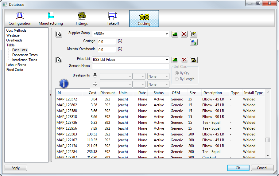

Access the price list database parameters by clicking Database Costing Price Lists.
The Autodesk Fabrication products include by default multiple price lists from various suppliers; for example, Lindab, BSB, Actionair, BSS, Wolseley Group, Georg Fischer, Pegler, Crane, and Hattersley. Users can apply their own agreed discount percentages to a price list.
Price Lists are available in two general formats: Product Code Based and Breakpoint Style.
On the Price List database dialog, the following general parameters are available for price lists:
Supplier Group: Name of the Supplier wanting to be displayed and categorized in Estimate Summary. Used to group price lists together from the same supplier ensuring the summaries/reports isolate the cost of each supplier across multiple price lists.
Carriage: Additional Net cost added to the price. (Supplier List Price - Customer Discount) - Carriage = Net Price). For example, this can be used to apply a transportation percentage from the Supplier to site, if there were charges for delivery.
Material Overheads: Extra supplier-based percentage mark up for inclusion into Gross cost calculations. Also accessed for each individual quotation from the Estimate Summary Overheads section.
Price List: Name of the Price List contained within the Supplier group. This is the table name assigned to the M-Rate field of each item.
Generic Name: Used for grouping Price Lists that contain the same product codes but from an alternative supplier. Allows Swap out of prices based on Generic name reference (this must be entered the same across Price Lists) from the Estimate Summary dialog. Right-click on the Supplier that is listed in the Summary Change Supplier.
