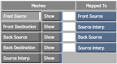

  2. Specify which mesh will be created.
    Click: To create:
    Front Source The front source mesh.
    Front Destination The front destination mesh.
    Back Source The back source mesh in a morph.
    Back Destination The back destination mesh in a morph.
    For information on when to create each type of mesh, see Warping and Morphing.
  3. Click Add Mesh.
