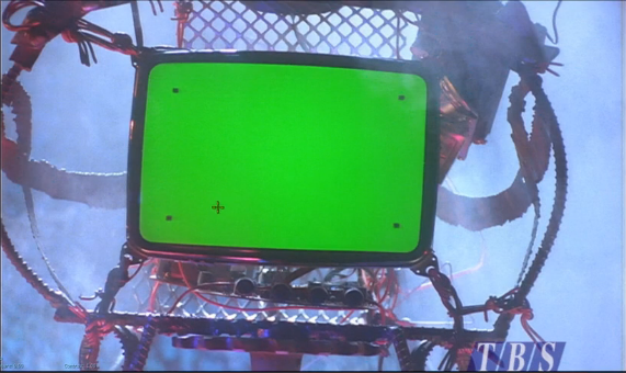

In this example, we want to replace the green screen in the TV clip with another shot.
Images courtesy of Turner Broadcasting Systems
However, when entering the stabilizer, we can see that we don't have proper anchor points on the TV clip, where the four corners of our replacement shot are positioned.

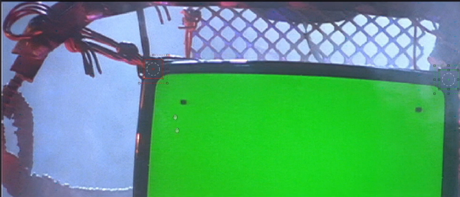

  1. From the Stabilizer Tools menu, select Offset Reference.
    This enables you to place the tracker on a proper anchor point, but apply the tracking data to the original portion of the image, which does not have an adequate anchor point.
  2. Place the trackers on adequate anchor points.

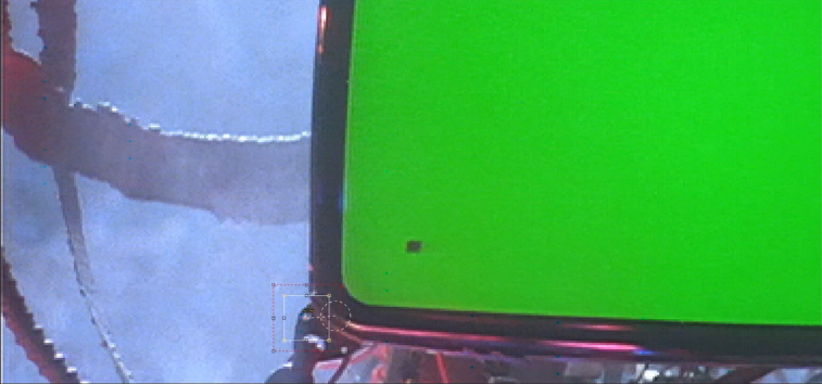

    Note: The trackers should be placed relatively close to the offset target, or on an anchor point that follows the same movement as the offset target, otherwise the detected motion will be off and will drift from the motion of the offset target.
    A dotted line is displayed between the tracker and the offset target.

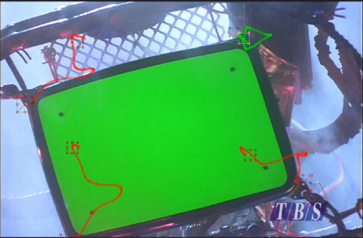

  3. Gang the trackers.
  4. Enable Auto Update Reference.
  5. Press Analyze.
    The motion is tracked. The reference is the anchor point on which the tracker was placed, but the motion is applied to the offset target.
