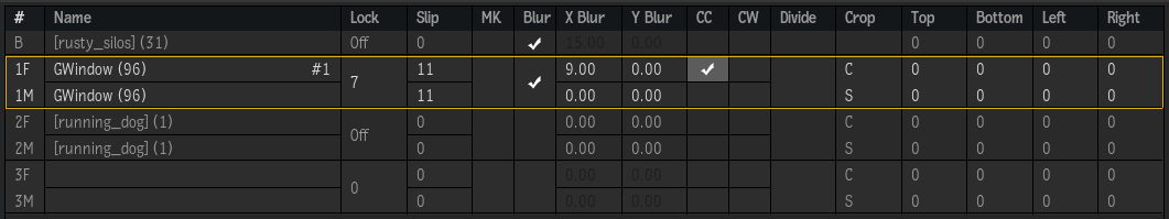

The Media list allows you to easily add and edit the following effects and tools to your clips. The same media can be applied to multiple surfaces, so any effects that you apply to one instance of media is applied to all the surfaces for that media. For example, if you blur media, all of the surfaces using that same media are blurred.
Note: If you are looking for Shadow Softness settings in the Media list, they can now be found directly in the
Shadow menu, allowing you to set shadow softness by object, instead of by media.
The effects and tools in the Media list appear from left to right in the order that Action processes them:
Lock and Slip
Use Slip to create a timing offset for your clip and Lock to lock media at a certain frame.
- In the Media list, drag the slip field for your chosen media.
A positive value starts the clip at the specified frame. A negative value creates a freeze frame effect where the first frame of the clip is held by the specified number of frames.
- To lock the media at a certain frame, drag the Lock field to the desired frame number, or click the Lock field to display the calculator to enter a frame number.
Ctrl+Alt click the field to return it to Off.

Blur
You can quickly add Gaussian blur along the X and Y axes in the Media list, or enter the full Blur editor to have access to all blur settings, including other blur types, such as Radial and Defocus.
- In the Media list, drag the X or Y blur values to apply a Gaussian blur, or double-click the corresponding Blur field for your chosen media to enter the full Blur editor.

Colour Corrector and Colour Warper
You can apply separate Colour Corrector and Colour Warper effects on Action media.
- In the Media list, double-click the corresponding CC or CW field for your chosen media to enter the Colour Corrector or Colour Warper.

Divide
When compositing with images generated by rendering 3D objects over a black background, unwanted black often appears on translucent or anti-aliased areas of the media. Use the Divide tool to divide the front media by its associated matte media, which eliminates the black edges in the composite.
- In the Media list, select the media containing the unwanted black.
- Double-click the Divide field of the media containing the unwanted black.
The selected media's front is divided by its matte, resulting in correct colour in areas of transparency.

To crop a clip with the Media list:
- In Action, click Media.
- Set values for cropping and softness in the Top, Bottom, Left, and Right fields. Once you set a value in one of the Crop or Softness fields, white checkmarks indicate that Crop and Softness are enabled.
(a) Softness area of Crop field (b) Crop area of Crop field

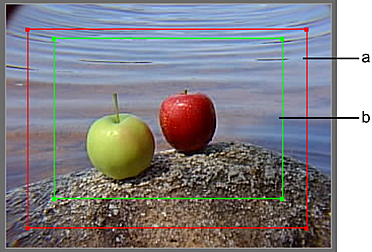

To crop gesturally in the image window:
- Double-click the Crop field to enable Crop and Softness.
- In the View box, select Media Front or Media Matte.
The clip appears in the image window with a red outline, which indicates the Crop box, and a green outline, which indicates the Softness box.
(a) Crop box (b) Softness box
Tip: You can use two viewports to view the crop interactively on both the front and the matte clips.
- Set the corners of the Crop box and Softness box by dragging either the corners or edges of the red and green outlines.
The crop and softness values in the Media list are updated as you drag.
- Click Result.
The cropped media appears in the image window, and the front and matte clip share the same crop.
