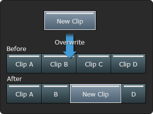

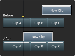

Overwrite Example

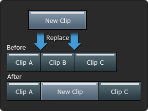

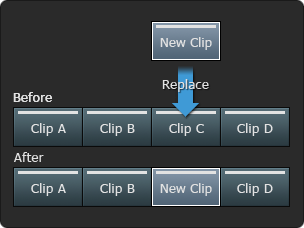

Replace Example

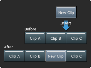

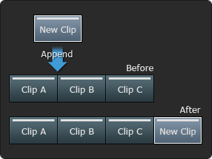

| Append | An insert edit that adds your source clip to the end of the edit sequence on the timeline. |

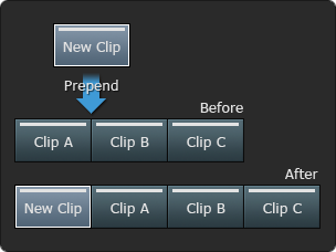

| Prepend | An insert edit that adds your source clip to the beginning of the edit sequence on the timeline. |

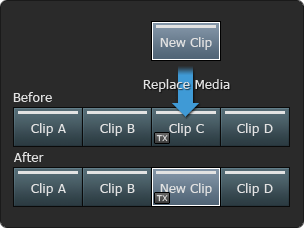

| Replace Media | A replace edit that retains any effects applied to the replaced clip or clips on the timeline. |

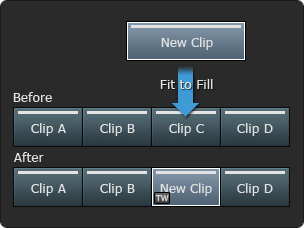

| Fit To Fill | A replace edit; but instead of adding tail frames to a longer source clip, a timewarp is added to the replacement clip so that it fits the same duration occupied by the clip it is replacing. |

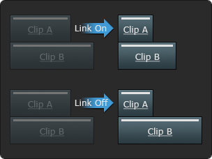

Link Example
