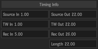

Timing Info Settings
These settings are only available if you accessed Timewarp as a Timeline FX, and entered the full editor. They are informational settings only, to give you information about the segment on the timeline.
- Source In field
- Displays the frame or timecode of the In point of the source segment. Non-editable.
- Source Out field
- Displays the frame or timecode of the Out point of the source segment. Non-editable.
- Timewarp In field
- Displays the frame or timecode of the In point of the timewarp result. Non-editable.
- Timewarp Out field
- Displays the frame or timecode of the Out point of the timewarp result. Non-editable.
- Record In field
- Displays the frame number or Record timecode of the In point of the segment in the sequence. Non-editable.
- Record Out field
- Displays the frame number or Record timecode of the Out point of the segment in the sequence. Non-editable.
- Length field
- Displays the length of the segment. Non-editable.
