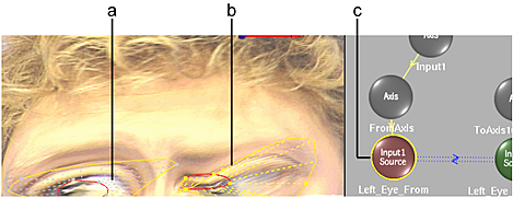

To show correspondences:
  1. Toggle on the visibility of the source splines and destination splines using the Show buttons.
  2. In the Distort tool, click Correspondences.
    Correspondence points are shown on the source and destination splines, and are connected by dotted lines. Selected splines show the connections with yellow dotted lines; unselected splines shown them in grey.
    (a) Correspondences of unselected spline (grey)  (b) Correspondences of selected spline (yellow)  (c) Selected spline in Distort schematic  

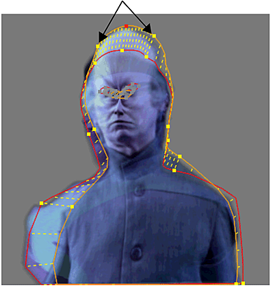

    Points can only be moved between the two points that surround it on the spline.
    The correspondence point can only be moved between the two surrounding points
    Image courtesy of Behavior Communications Inc.
    The warped or morphed region is remapped according to the changes made to the correspondence points.

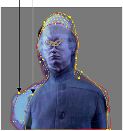

To add correspondence points:
  1. Click Correspondences to display the correspondence points.
  2. Select Add from the Tools box.
  3. In the region of the clip where you want to improve the mapping, click the source or destination spline to add a new correspondence point.
    A point is added. As well, a corresponding point is added to the corresponding spline. You can then move either of these points to improve the mapping of the clip. The more correspondence points there are, the more refined the distortion.
    Adding a correspondence point to a source spline adds one to the destination spline
